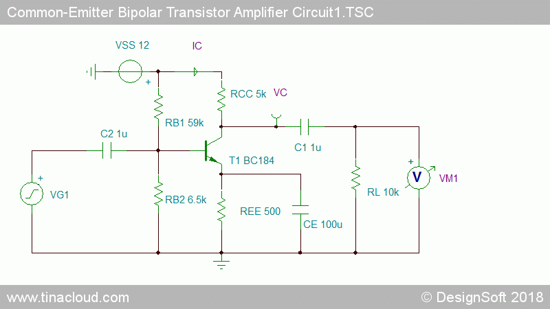

[image][Common-Emitter Bipolar Transistor Amplifier Circuit1.tsc] [image]
Click the link above and a circuit will appear, which you can check online with TINACloud. Now you can also use the Interpreter to carry out the calculations with formulas. Tap or click the blue Interpreter program area then press Run to see the results.
