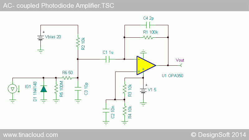

[image][AC- coupled Photodiode Amplifier.TSC] [image]
The input signal is a 10khz 10uA peak current from a general photodiode, modeled with 1mA DC current due to the ambient background light. The amplifier shows a bandwidth over 10khz. You can analyze this circuit on-line with TINACloud, without any registration, by clicking the link above.
